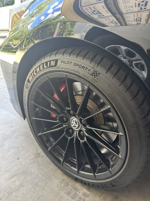

1. Spacers
2. Locking Lugs (Gorilla-all of them lock)

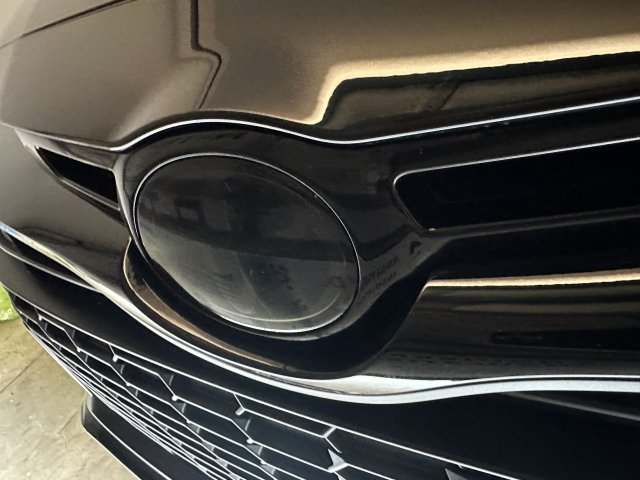

4. Tint on Emblems

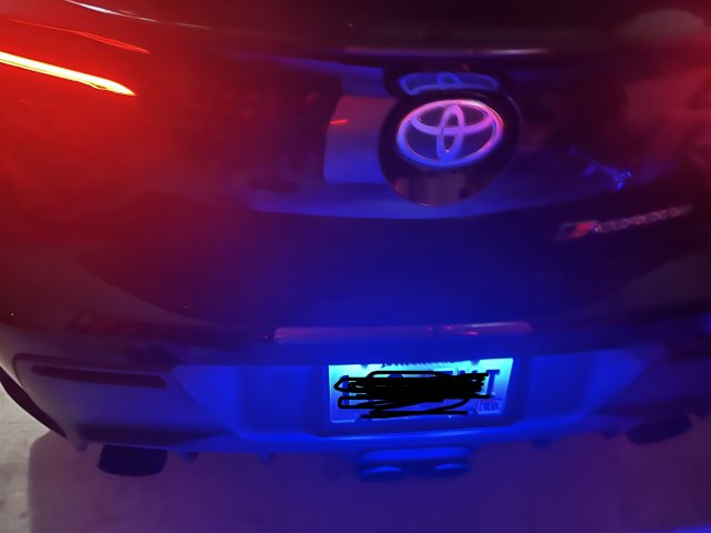

5. Blue Foot well LEDs
6. VLEDs blue license plate LEDs

4. Tint on Emblems

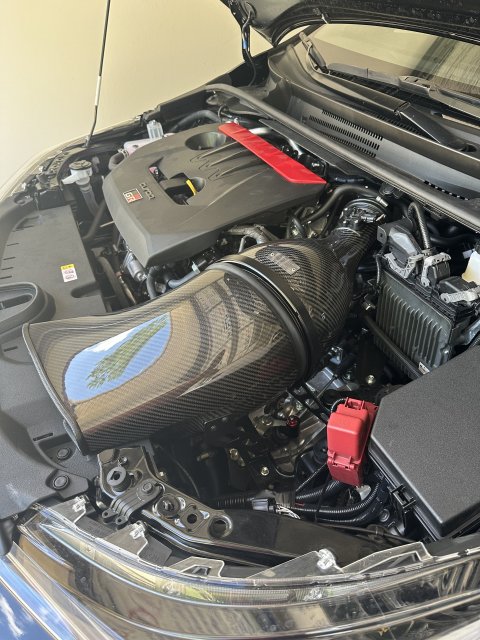

Would love to hear your thoughts on the intake.
The Eventuri was causing some code for other but never on mine, The recently discovered a 6.5 inch length vacuum hose dampened the signal to the crank case sensor. The air flows much louder on full throttle, and I believe its quicker in the low RPMs. Its by no means annoying as my Milltek is not either. I could feel it pull harder after first install and WOT. It looks amazing with hood popped and the red air channel is very visible as you walk up to front of car.

We've pre ordered on SXTH Elements CEL fix for the intake. It's retaining all the OEM fittings.
NIce look for the intake for sure. However we're going to stay with the Forge Motorsport complete system. It's well engineered and developed first for the GR Yaris and then the GR Corolla.

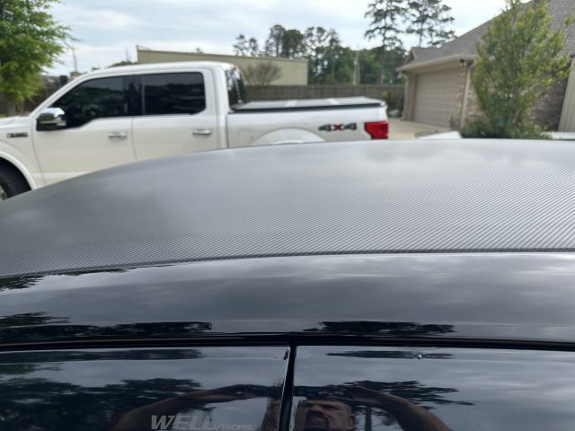

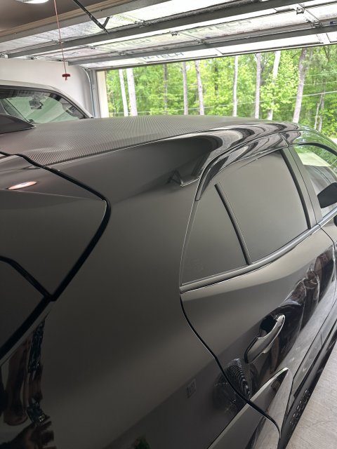

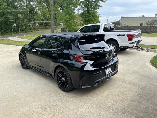

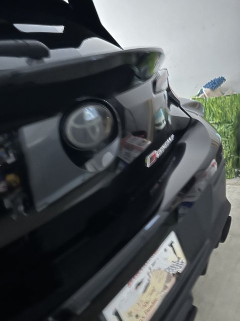

Your ducktail spoiler: Where did you purchase it and is it painted or simply gloss black? Going to do this one for sure but just researching them now.

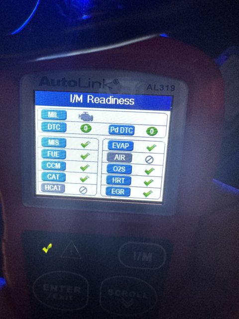

How did they ended up fixing the CEL issue?

The ducktail spoiler was purchased off of ebay pre painted, good price compared to other sites.
They extended the vacuum hose rom 3.5 to 6 inches going to the crank case pressure sensor. this is the vacuum hose off to the right of the Y hose splitter. There is also a tune fix for this CEL.
